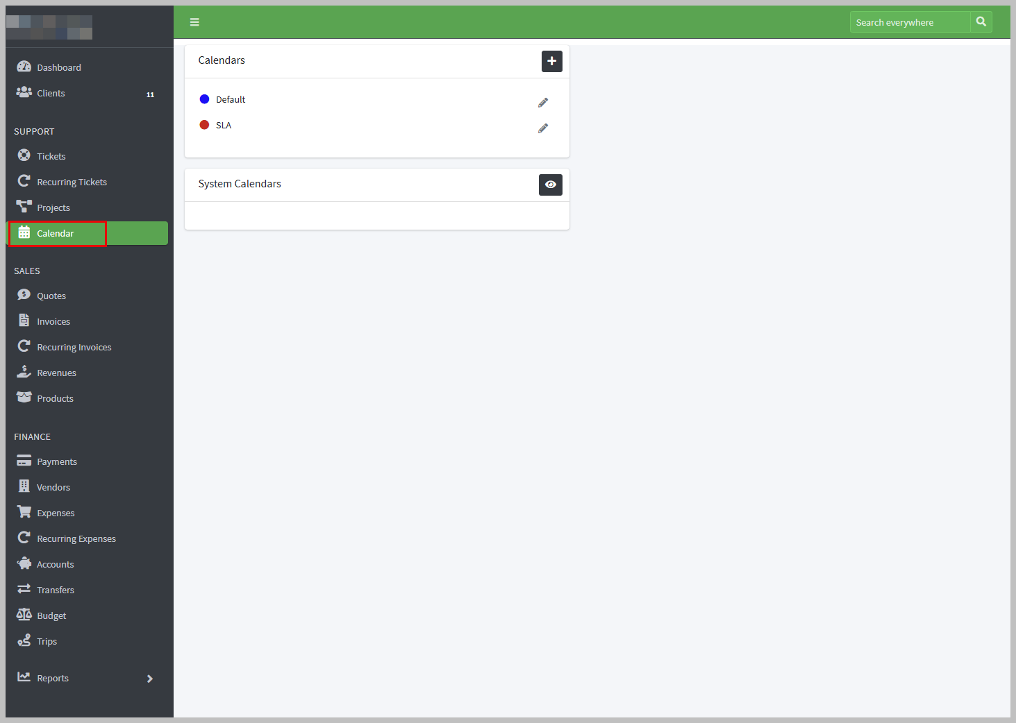

I have to go out now for a job, when I got to the main menu and calendar, this is what I see
I have added 1 named SLA a few months back, it seems I can't delete it.

When I go the path you say, I only see the screen I have posted above.
